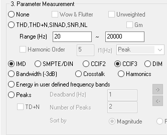

Save panel setting CCIF3
Post by marth »
Hello! Saving panel settings with parameter CCIF3 causes the program to crash when opening this setting. I'm using version 3.9.7.3 with a sound card ADI-2 PRO fsr. I am attaching the settings file.
IMD_CCIF3_FFT131072_SR48000_SingleChannel_ADI2.zip
(1.14 KiB) Downloaded 4561 times
Re: Save panel setting CCIF3
Thanks! This might happen if the selection is switched from DIM to CCIF3. It has been fixed in the new version 3.9.8.0.
