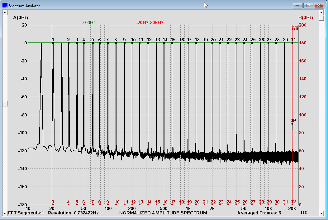

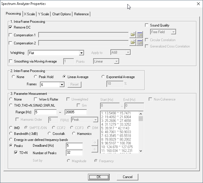

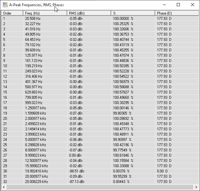

VirtinsTech wrote:8. Increasing Record Length and FFT size will increase the peak detection resolution, which is determined by FFT resolution and the width of main lobe of the window function used.
Well, sure.
But still, I don't get hwo this works.
Here is an example:
MT32 - Peak detection - FFT Crop.png (34.2 KiB) Viewed 364610 times
MT32 - Peak detection - Frequencies.png (28.91 KiB) Viewed 364610 times
MT32 - Peak detection - Settings.png (27.55 KiB) Viewed 364610 times
(You may find the multi tone definition in the topic you linked to 2,3,5)

Thanks for your posting on AudioScienceReview.
Well, sure.
But still, I don't get how this works.
Here is an example:
The resolution of the peak detection function in MI is defined by the Dead Band and the width of the main lobe of the window function used, whichever is wider. The role of the main lobe is not mentioned in the current software manual. It will be updated.
The main lobe width used in MI is usually equal to or greater than 15 x [frequency resolution] depending on the Window function used. If rectangle window is used here, then the finest resolution of the peak detection would be 15 x [frequency resolution] = 15 x 0.732422Hz = 11 Hz. This explains why 25Hz is missing between 20.508Hz and 32.227Hz. Increasing Record Length and FFT Size should solve the problem.
