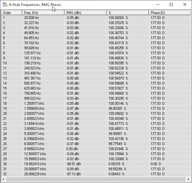

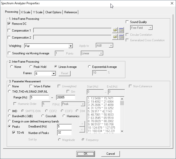

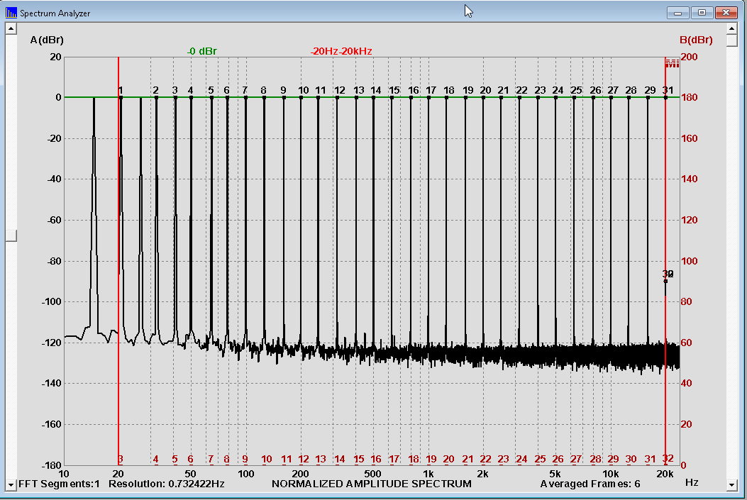

8. Spectrum analysis: Peaks detection
Mutlitone (32 tones) analysis is very helpful for Audio measurements.
I use AudioPrecision generated 32 tone WAV files.
But it always misses the 25Hz tone, for some reason, even in Rectangle FFT window with perfect sync.
I wonder if there would be a way to give more control on the selected frequencies.
OK, if the above point 7 is sorted, I could also do all that manually.
Would have to re-compute TD+N myself though.

VirtinsTech wrote:8. Increasing Record Length and FFT size will increase the peak detection resolution, which is determined by FFT resolution and the width of main lobe of the window function used.
Well, sure.
But still, I don't get hwo this works.
Here is an example:
MT32 - Peak detection - FFT Crop.png (34.2 KiB) Viewed 697473 times
MT32 - Peak detection - Frequencies.png (28.91 KiB) Viewed 697473 times
MT32 - Peak detection - Settings.png (27.55 KiB) Viewed 697473 times
(You may find the multi tone definition in the topic you linked to 2,3,5)

The resolution of the peak detection function in MI is defined by the Dead Band and the width of the main lobe of the window function used, whichever is wider. The role of the main lobe is not mentioned in the current software manual. It will be updated.
The main lobe width used in MI is usually equal to or greater than 15 x [frequency resolution] depending on the Window function used. If rectangle window is used here, then the finest resolution of the peak detection would be 15 x [frequency resolution] = 15 x 0.732422Hz = 11 Hz. This explains why 25Hz is missing between 20.508Hz and 32.227Hz. Increasing Record Length and FFT Size should solve the problem.
Re: Wishlist (from current version 3.9.8.1)
Post by RJA4000 »
Thanks for the explanation.
Indeed, it makes sense to add it to the manual. That will be more obvious to everyone.

To compute bin start and end, we need Round function, Sampling frequency and FFT size.
