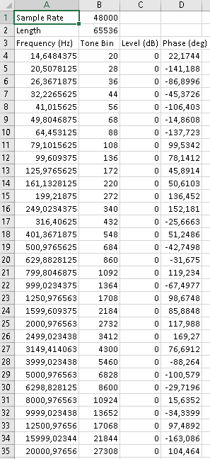

Strange. (Or maybe I don't understand it ?)
It seems I can create composite signal without spectral leakage for 2 or even 32 tones without them to have to be harmonics of a common fundamental frequency.
That's what Audio Precision does for their 32 tones Multitone, as an example, and they use that characteristic to even retrieve the noise from the bins where they know for sure there can't be any harmonics.
(See https://www.ap.com/technical-library/us ... udio-test/)
AP Multitone.PNG (19.39 KiB) Viewed 250369 times

A "No Spectral Leakage" checkbox will be added in the MultiTone Configuration Dialog box. It will be enabled for selection if all tones are sinewaves. Other waveforms including white and pink noises cannot be added if this option is selected. No dither can be added either. The maximum number of tones in each channel will still be 200 for this option. The actually generated frequencies will be the nearest no-spectral-leakage ones to the configured frequencies. When this option is selected, the frequency specified does not have to be rounded off to an integer value, and thus it is possible to aim at any FFT bins.
They are actually harmonics of [Sampling Frequency]/[FFT Size]. The generated Multitone is still periodic.
