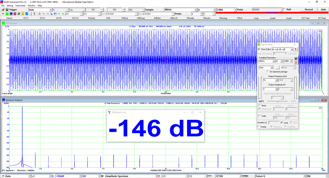

Re: Doubts about Multi-instrument
Posted: Mon Mar 21, 2016 7:15 pm
Multi-Instrument is well suited for low THD and noise measurements for HIFI audio devices. The lowest distortion and noise that can be measured is practically only dependent on the measurement hardware used, e.g. sound cards, VT DSOs, NI DAQmx cards, etc.. The distortion and noise introduced by the numerical computation of the software itself is negligibly small even compared with the best precision measurement hardware available today. The following screenshot shows the distortion and noise introduced by the numerical computation of the software itself (24-bit ADC and DAC precision). It shows that the THD+N is only -146dB. In the screenshot, software loopback mode "iA=oA, iB=oB" is used without any involvement of the sound card hardware.
