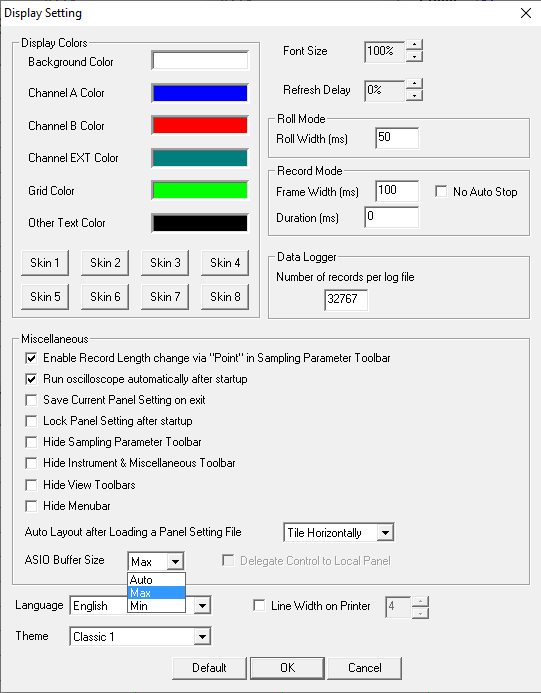

By default, Multi-Instrument will set the ASIO buffer to Maximum. You can change the default setting via [Setting]>[Display]. Not sure whether this will help in your case or not.

ASIO buffer size : already be selected to MAX.

Under "Normal" trigger mode, the software will perform software trigger processing which prefers a big ASIO buffer size to be efficient. You can try the following to see if it can solve the problem.
1. Set [Setting]>[Display]>"ASIO Buffer Size" to Max or Auto
2. Change the Trigger Mode from "Normal" to "Auto"

ASIO driver : ASIO4ALL
Triger mode : Auto
ASIO buffer : MAX( and same, AUTO)
results: no effect as attached pic1.
