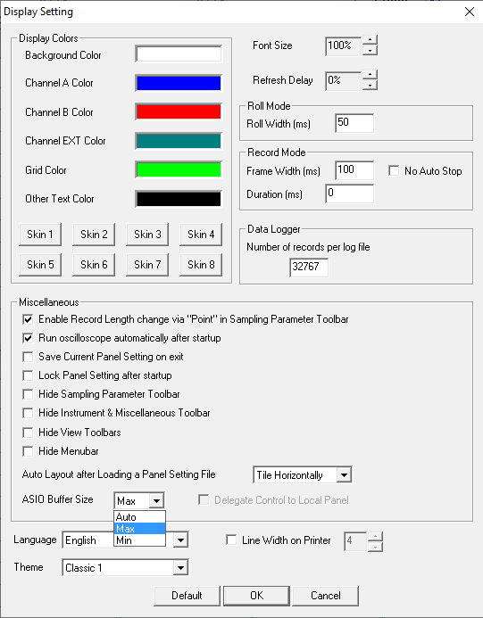

By default, Multi-Instrument will set the ASIO buffer size to Maximum. This helps the software to buy some time to perform some extra processing such as software triggering. Some hardware may not follow ASIO standard strictly, which causes "Buffer Size Exceeded" when the maximum buffer size is requested. You can change the default ASIO buffer size via [Setting]>[Display]>"ASIO Buffer Size".

This is the first thing I tried: Change this setting.
Unfortunately, it doesn't help.
I tried the 3 options. I also made sure the Topping driver was selected with same number of bits than MI
That still doesn't work.
2022-10-21 18_22_07-Display Setting_.png (734 Bytes) Viewed 371028 times

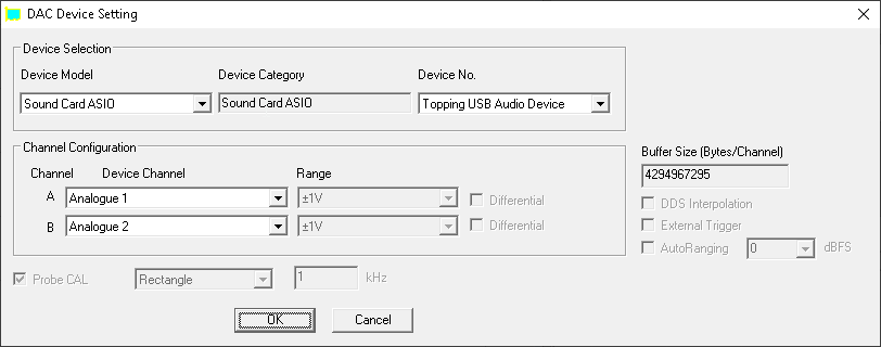

2022-10-21 18_22_14-DAC Device Setting.png (10.62 KiB) Viewed 371028 times

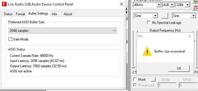

That is strange if you have tried all the three options: Max, Auto and Min for both Oscilloscope and Signal Generator. The Max and Min options use the maxSize and preferredSize returned by the ASIO driver directly. Not sure whether it returns a correct size. Could you please show the Buffer Setting tab of Topping USB Audio Device Control Panel?
Re: Topping ASIO driver - Buffer size exceeded
Posted: Sat Nov 05, 2022 4:52 pm
What do you mean by "for both Osclloscope and generator" ?

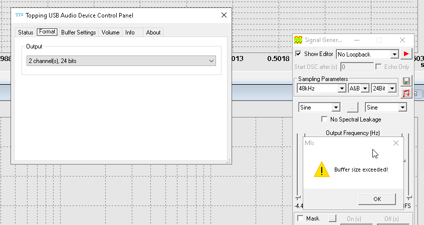

I just added a driver for Fiio BTA30 pro (DAC driver, with ASIO), and I have the exact same phenomenon
Buffer Size.PNG (12.58 KiB) Viewed 370855 times
This error shows only when I start the generator.
Of course, both devices are DAC only. Not ADC.

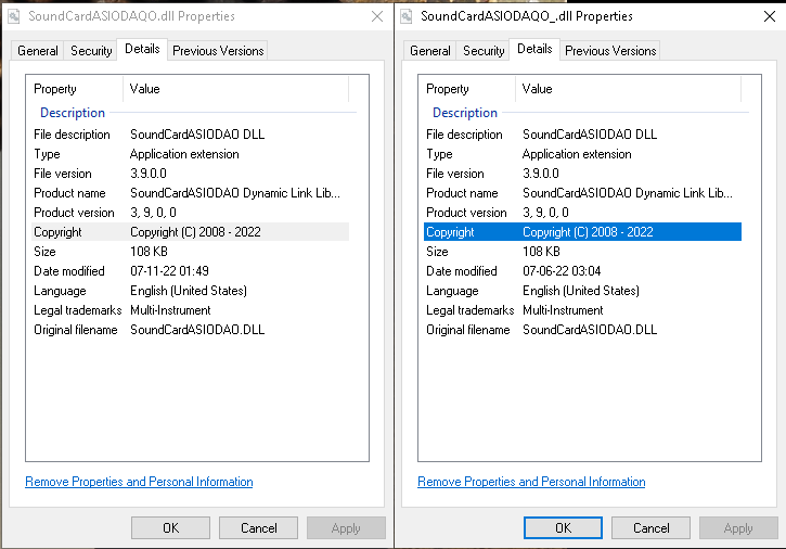

There should be a third place, though.
Since I still get the same message with your latest DLL, with no pop-up...
Still, I checked, and they are all different.
