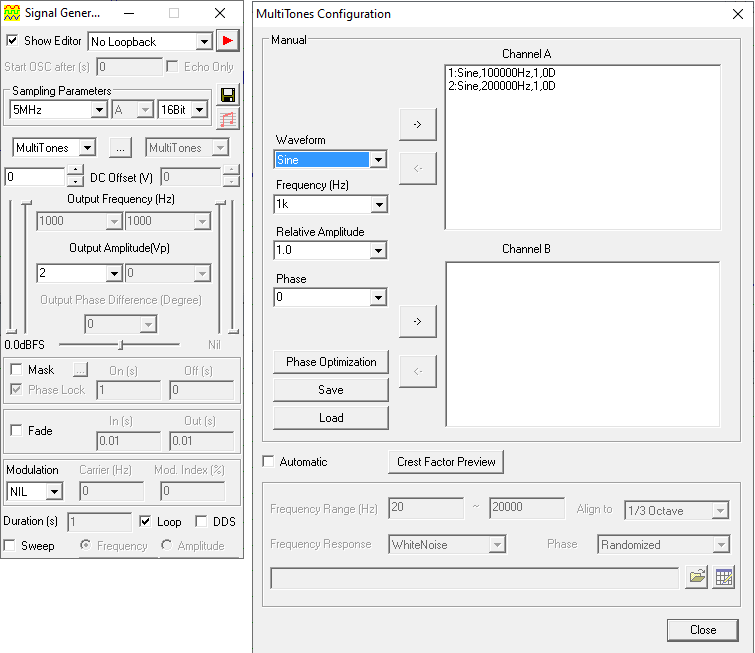

Can the VT DSO...-E signal generator output in the single output a dual tone (multi-tones) from the VI software? The signal generator in the software automatically activate the A & B in multi tone selection option. Would the hardware from the DSO combine the two since there is only one digital output connection on the DSO? It would be like converting a stereo output into a mono output. I am considering to get one of those units and that features would be attractive to me. I already have VI software pro since 2018. I can do that using my soundcard using a stereo to mono convertor which is cool. I would like to be able to do that in much higher frequencies than are possible with soundcards. I tried to upload a image but I could not see it in previous so I don't know if it worked.

When the device has only one analog output channel, only one channel will be activated on the signal generator panel (see picture below). MultiTone is supported only under streaming mode (non-DDS), therefore the maximum sampling rate sustainable is about 5MHz (16 bits, single channel) without the oscilloscope running.

Streaming mode uses the USB bandwidth to stream data. The current VT DSOs support USB 2.0 high speed which is about 480 Mbits/s. Our tests show that the max. sustainable sampling rate for either the oscilloscope (for input) or the signal generator (for output) is about 10MHz @ 8 bits, single channel. If both the Oscilloscope and the signal generator are running, the max. sampling rate will have to be at least halved.

On the other hand, it is possible to define the waveform of a multitone using a CSV file (see Section 4.3.1.9.1 Waveform Library File (*.wfl) of the software manual) and then use the DDS mode of the signal generator of the VT DSO to generate it. In this way, the limitation of the streaming mode is avoided.
