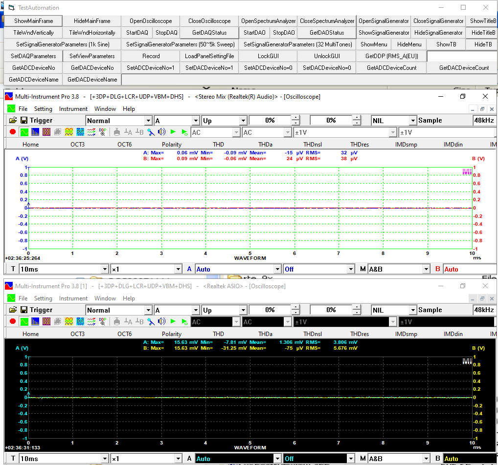

Multiple instances of MI on the same PC, no matter launched directly or through ActiveX automation API, are allowed with one license.
1. Launched directly
1) If the first instance of MI is launched for the very first time, it will prompt the user to select default device and skin for the first instance.
2) If the second instance of MI is launched for the very first time, it will prompt the user to select default device and skin for the second instance.
2. Launched through ActiveX automation API
2) If the second instance of MI is launched for the very first time, it will prompt the user to select default device and skin for the second instance. The prompt will still show up for subsequent launch of the second instance. The latter is a bug and will be corrected in the next release.
In the next release, these prompts will be always disabled if MI is launched through ActiveX automation API. Configuration of default device and skin can be done through the launched MI HMI or by supplying the configuration file scins.cfg, scins1.cfg.......These configuration files can be configured through MI and obtained from MI's root directly.

The resulting screenshot is as follows:
