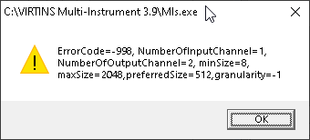

Thanks for the information. There is another dll called SoundCardASIODAQO1.dll which is exact the same as SoundCardASIODAQO.dll. Please update that one as well and see if the debugging information pops up. Thank you very much in advance!

Now I see something
2022-11-10 06_58_33-C__VIRTINS Multi-Instrument 3.9_MIs.exe.png (3.74 KiB) Viewed 198713 times
I have exactly the same error with the Topping driver and the Fiio driver.
I may change the "preferred size" by setting the driver's buffer size directly.

Thanks a lot for the information. It definitely helped. Could you please try this updated one at: https://www.virtins.com/FileDelivery/So ... IODAQO.dll
Re: Topping ASIO driver - Buffer size exceeded
Posted: Fri Nov 11, 2022 3:46 am
Now that works !
For both: the Topping and the Fiio
Thanks !

The fix has been included in the new release V3.9.7.0 which is now available for download. Thanks!
