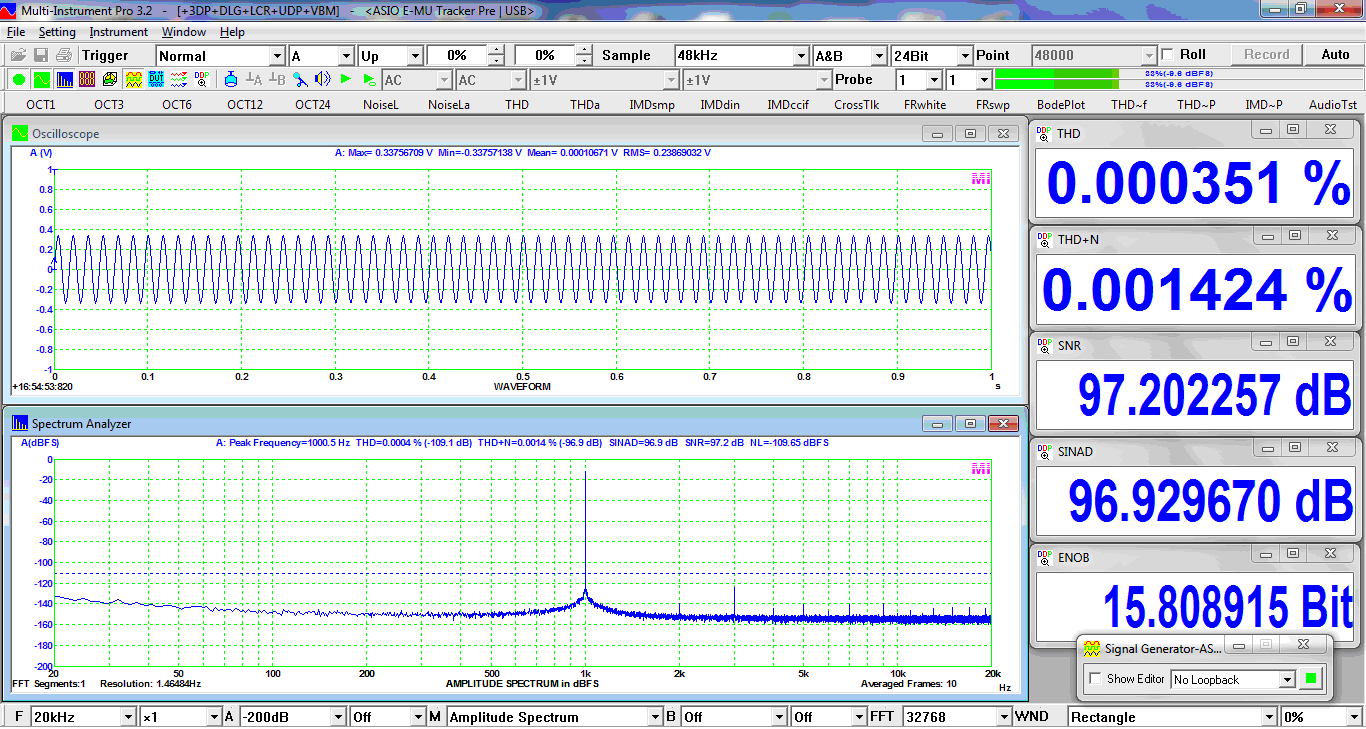

A displayed waveform should always use the max and min of all sample used in one pixel-column.
In the current MI-Version 3.2 a bad interference is shown.
Misbehaviour is best seen with a sine of const ampl. & freq.:
The wave is going up and down in shown graph even though everything is constant.
This way small peaks are sometimes only visible in max zoom
confusing...?
Well, a picture can tell more than 1000 words, but there is no possibility to do an upload
AVM
Post at 25-7-2011 20:43
In MI, there are two display modes for a graph:
(1) Display all data points
(2) Display one data point per vertical raster line.
Method 1 is thorough but slow while Method 2 is fast but not thorough. Please refer to Section 2.6.2.10.3 of the software manual for details. The issue you mentioned is due to the latter mode and can be solved using the former mode, or zooming in sufficiently.
"use the max and min of all sample used in one pixel-column" is a good method to correctly depict the envelop of the waveform, but it requires more computing work than the above Method (2), and thus slow especially when the number of data points in one frame is big. If the slow screen refresh rate is not a problem, then Method 1 can be chosen to avoid the disadvantage of Method 2.
By the way, pictures can be uploaded in this forum.

I can't work it out (MS-IExplorer 8).
I do not see any possibility to upload anything (well, ok, i can insert a link to a picture - but no upload).
But never mind: You understood already my thoughts.
AVM
Post at 27-7-2011 13:26
upload image (gif)
