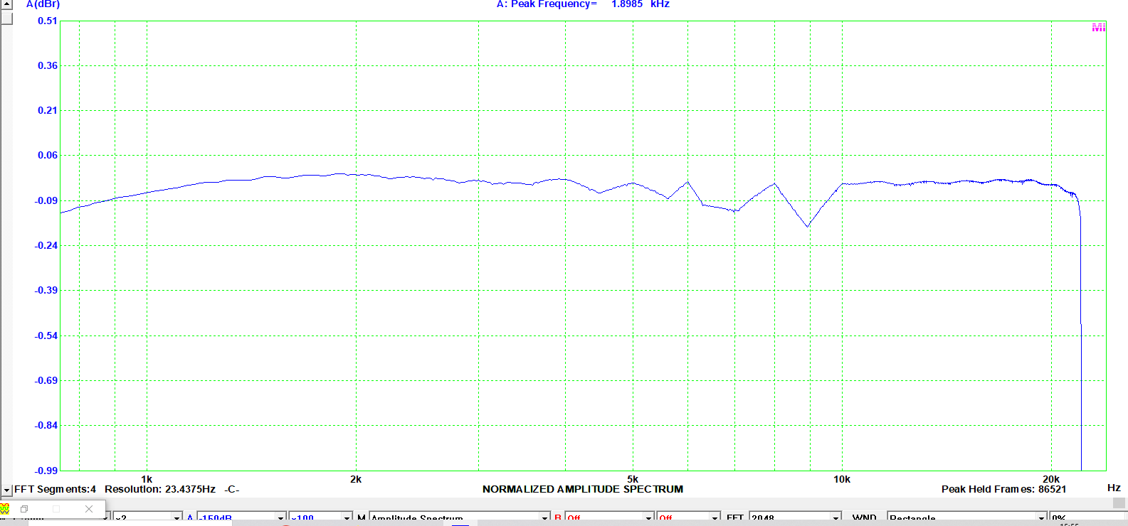

chrip1k 21000 riaa.PNG (46.66 KiB) Viewed 946301 times
sorry for my "auto" english
after a lot of checking with different machines and software approaches, cal files or the precise use of the mathematical function, it turns out that there are accidents that appear with both files systematically ..... between 3khz and 10khz ... would it be possible to check or improve these cal files?
here a tested inverse riia and a normal riia card
small ps could you specify which riaa approach you use? there are so many "riaa" iec din etc ... (at home always a slight drop under 1k with your approach, but maybe due to my machines)

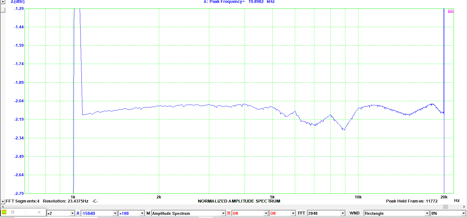

riaa inverse virtins.PNG (48.83 KiB) Viewed 946300 times
another machine...." inverse riaa"

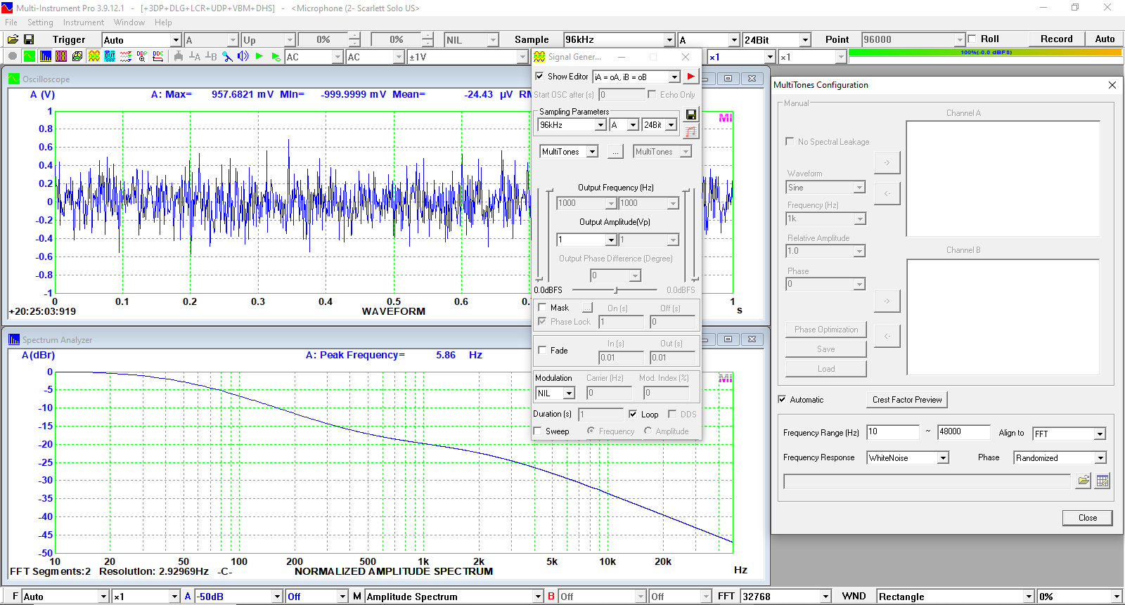

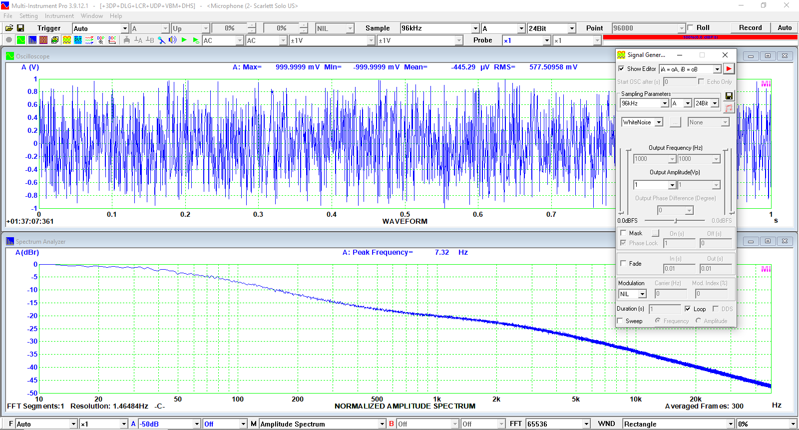

Here is what the playback RIAA curve looks like by using the ReproducingRIAA.fcf as a frequency compensation file in Multi-Instrument. The test signal is a 10Hz~48kHz bandlimited "Periodic White Noise" digitally generated by the Multi-Tone function of the Signal Generator of Multi-Instrument.

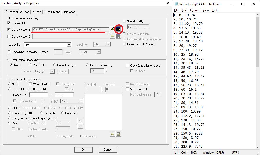

ReproducingRIAA.fcf is a CSV text file which can be viewed and edited using Windows Notepad as follows.

(2) If you use a non-repetitive normal white noise, you have to average the result to get a thin curve, unlike the case of using a "periodic white noise".

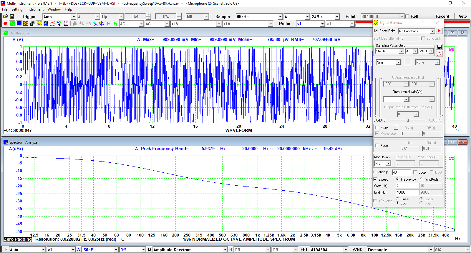

(3) If you use frequency sweep, you have to capture the entire sweep in one single oscilloscope frame from start to end, and the FFT Size must be greater or equal to the Record Length, and the window function must be rectangle ....
Here is an example of using a normal white noise.
Below is an example of using a log sweep and 1/96 octave analysis.

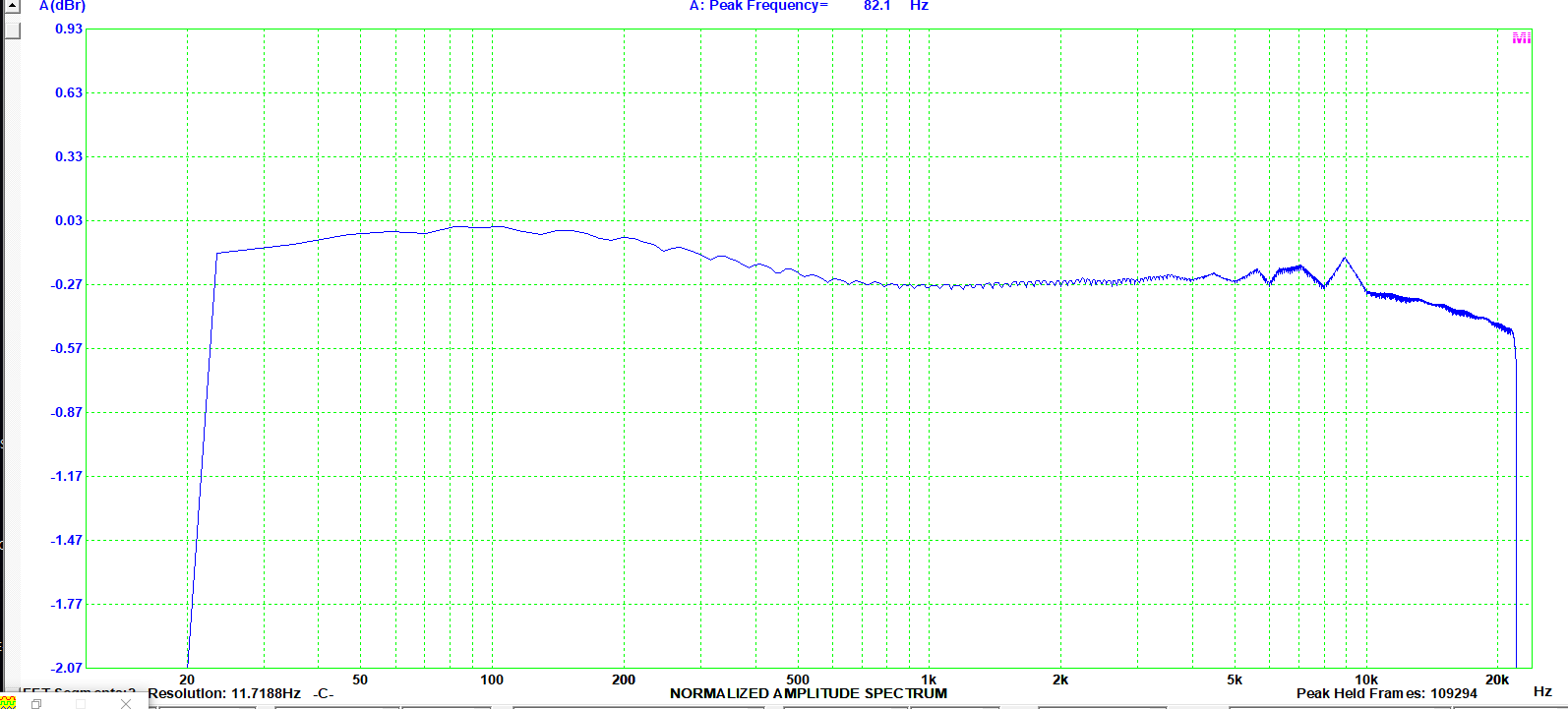

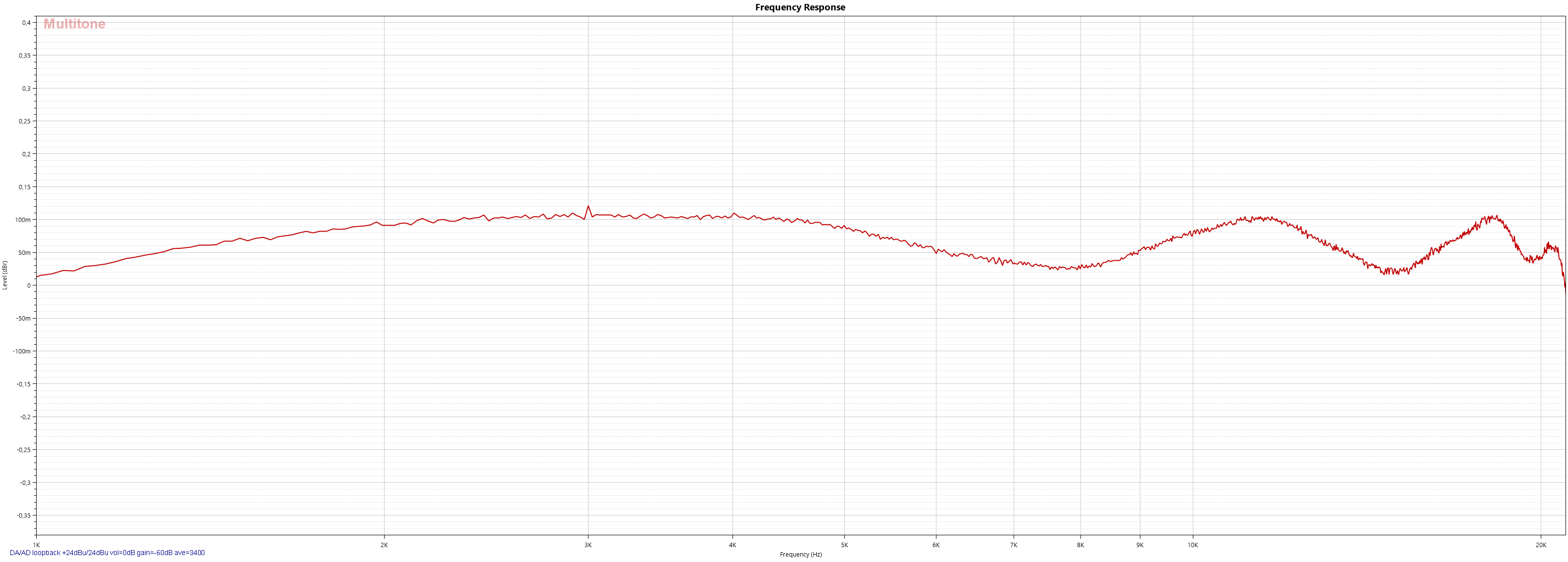

Frequency Response.png (86.3 KiB) Viewed 946285 times

Post by morillon »
it seems to me that it is not the method but your cal file which has this particularity... ;)

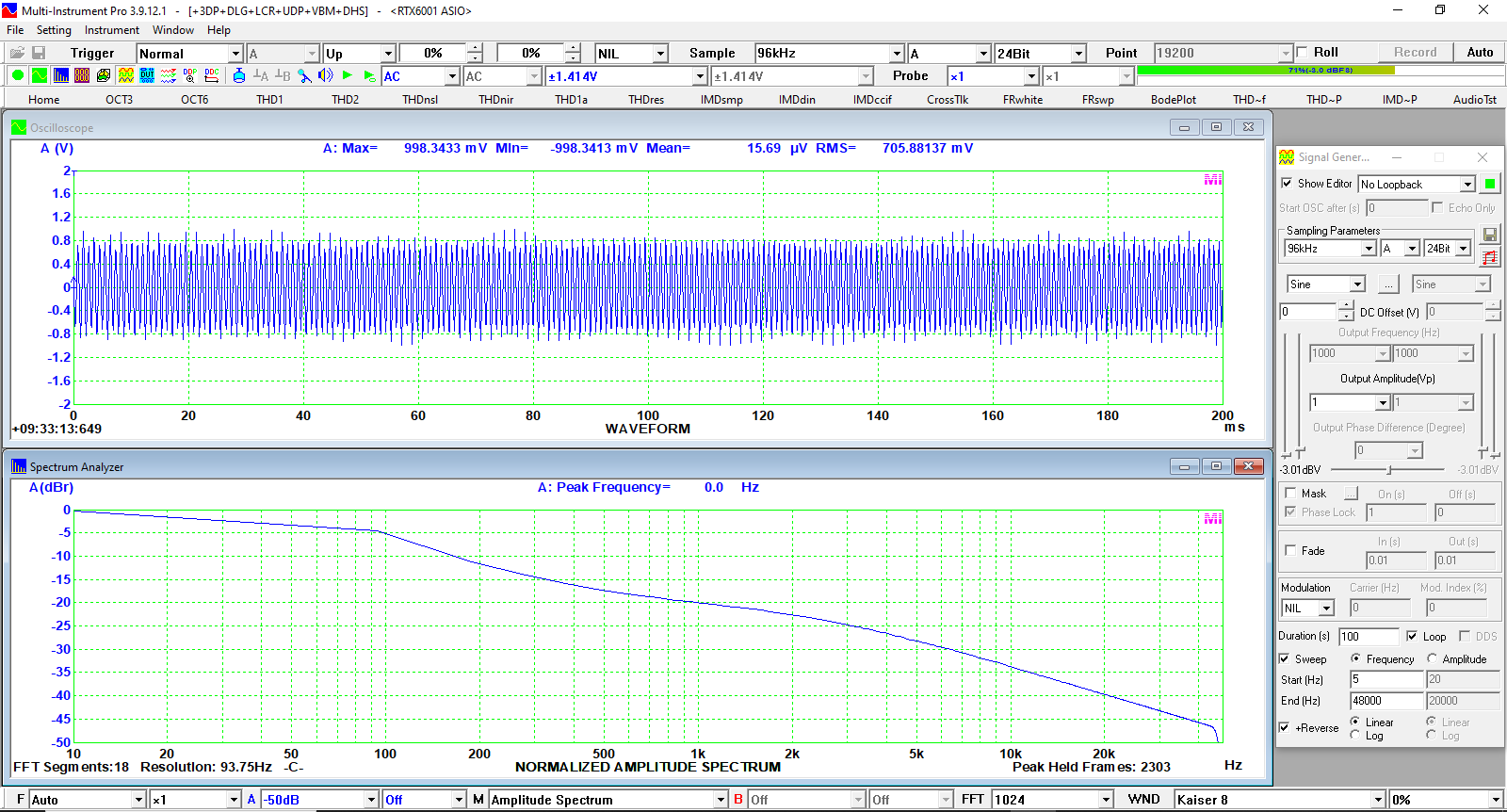

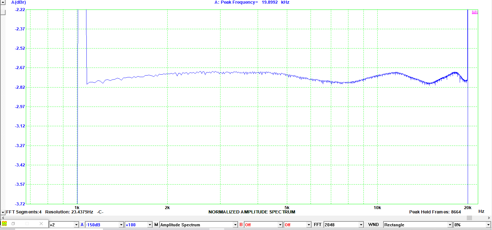

Here is the reverse RIAA curve measured using the peak hold method, with all testing parameters displayed. Generally, the longer the frequency sweep time per round, the smoother the curve. To achieve an even better curve at the low frequency end, the Record Length (currently 200ms) needs to be even longer.
Not all of your testing parameters are visible. You can upload your peak-hold panel setting file for diagnostics.
