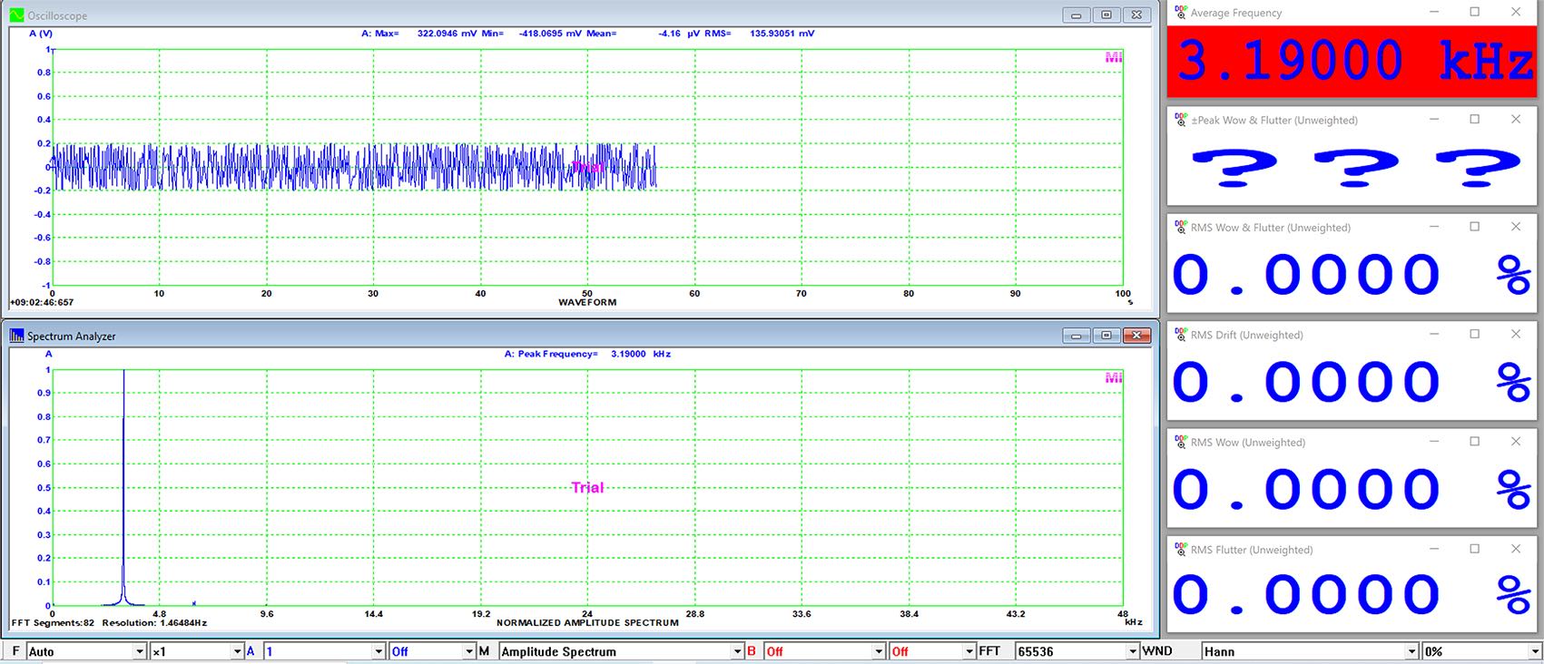

Postby Steveh100 » Sat Apr 03, 2021 4:18 pm
Your method 2 (Real Time Measurements) works fine
Method one gives me this as per the attached file
Av frequency but nothing else
imported wav.jpg (218.02 KiB) Viewed 42421 times
Steveh100
Posts: 5
Joined: Wed Mar 31, 2021 7:00 pm
Re: Measuring Wow & Flutter of existing 3150Hz recordings
Postby VirtinsTech » Sun Apr 04, 2021 1:21 am
In the current version, the Wow and Flutter measurement will not be performed if the Record Length in the Oscilloscope exceeds 2097152 samples (about 43.69 seconds if sampling rate is 48kHz). You can use [File]>[Extract] to save a shorter copy of your recording and then use [File]>[Open] to open that copy to analyze.
