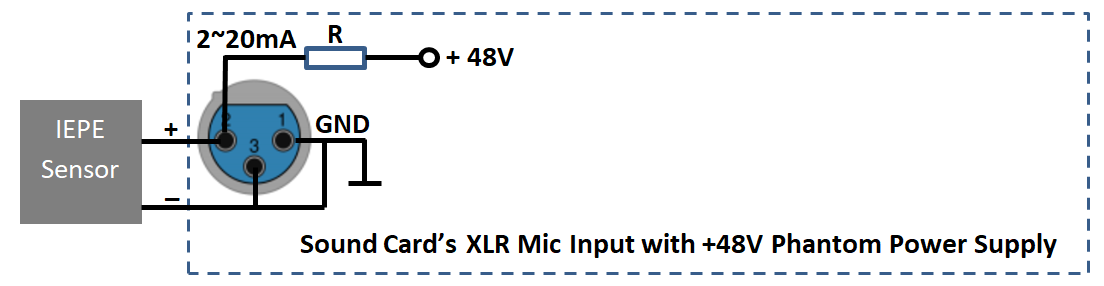

Some sound cards have XLR mic inputs with built-in 48V phantom power supplies. On the 48V pin, there is an internal current limiting resistor in series which would limit the current to be less than 20mA even if it is shorted to GND. If the IEPE sensor is able to withstand 48V, then an easy and workable solution (admittedly not very professional) is available as follows. In this way, the external 24V 4mA constant current power supply is not needed.

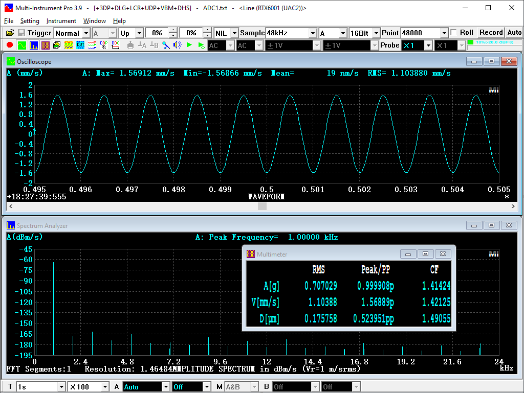

CA-YD-160 is an accelerometer. It does not measure displacement directly. In Multi-Instrument, an acceleration signal can be converted to a velocity signal and then a displacement signal through single integration and double integration. The following shows a simulated 1kHz sinewave with a peak acceleration of 1 g. It can be seen the measured peak velocity is 1.57 mm/s, and the measured peak-to-peak displacement is 0.524 um.
Acceleration
(Acceleration)
Velocity
(Velocity)
Displacement
(Displacement)
The IEPE sensor requires 24V 4mA constant current power supply (not a 24V constant voltage power supply) as shown in the previous posting. Measurement of absolute acceleration, velocity and displacement require voltage measurement being calibrated. These requirements need to be satisfied when using a sound card to interface to a IEPE sensor. Alternatively, VT IEPE-2G05 can be directly used with any IEPE sensors.
