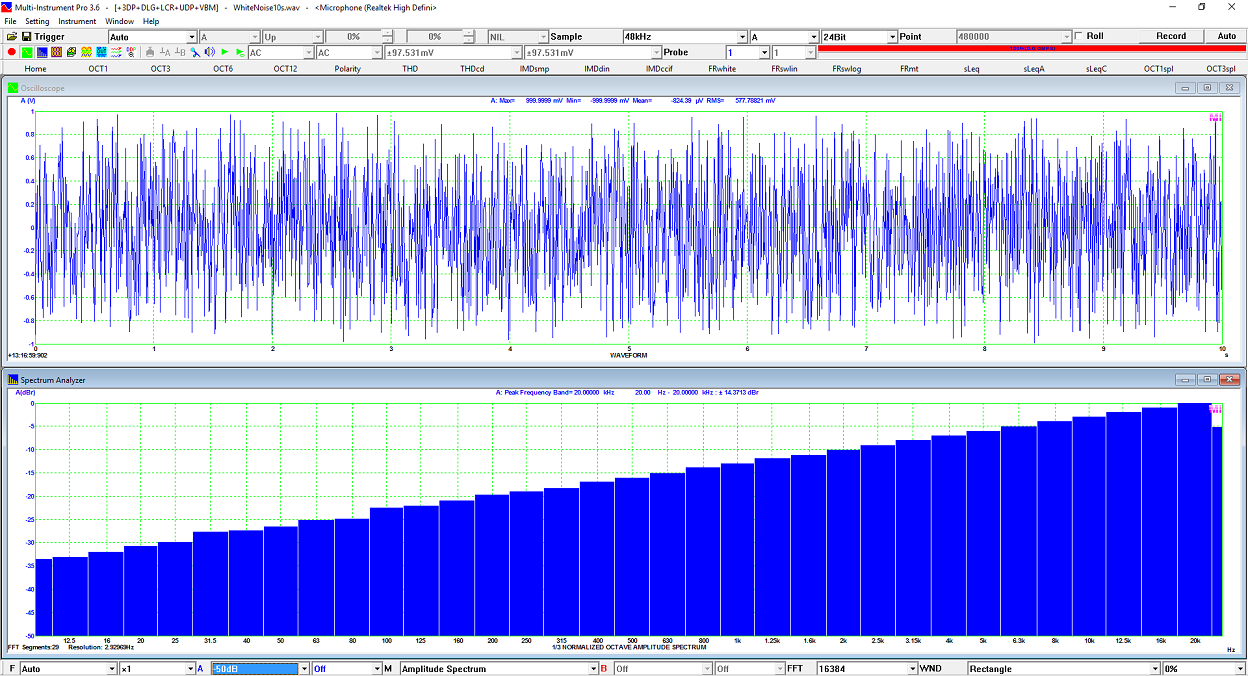

1. Let's use the following trick to generate an inverted pink noise response:

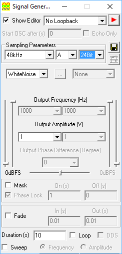

1) From the Signal Generator panel (see figure below), generate a 10s white noise and save it to hard disk.
2) Use [File]>[Open] to open the saved white noise file
3) Set the X Scale of the Spectrum Analyzer to 1/3 octave
4) Set the Y Scale of the Spectrum Analyzer to dBr
5) Now we get a frequency response of an inverted pink noise as follows.

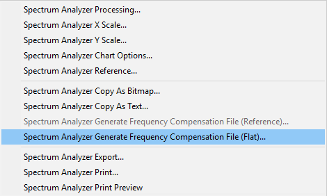

2. Right click the Spectrum Analyzer window and select "Spectrum Analyzer Generate Frequency Compensation File (flat)" to generate a Frequency Compensate File (FCF) which compensates the inverted pink noise response to a flat response.

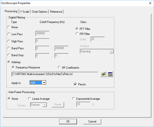

3. Right click the Oscilloscope window and select [Oscilloscope Processing]>"Digital Filtering">"Arbitrary">"Frequency Response", and load the FCF file saved previously

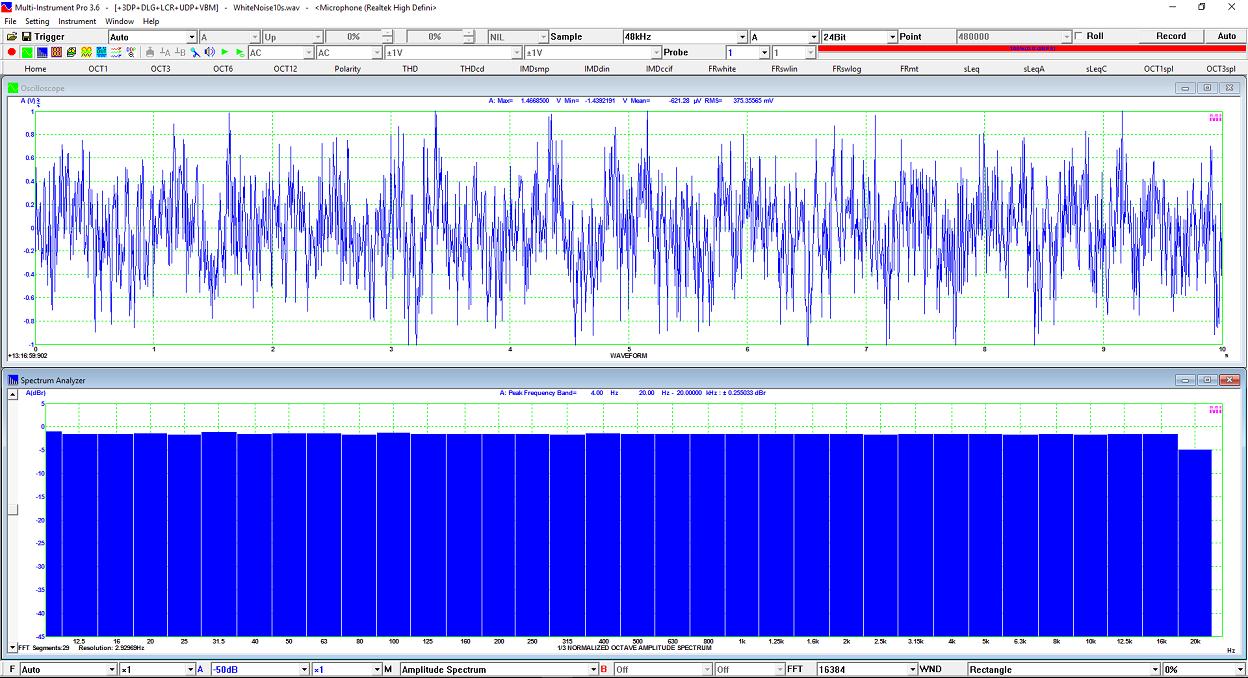

Note: it is in the FCF subdirectory instead of the FRF subdirectory. Also, you will need to change the "Files of Type" in the File Open dialog from "Frequency Response File (*.FRF)" to "All Files (*.*) in order to see it. Then select "Persist" as you want to persist the change in the data. Now, you will see the frequency response displayed in the Spectrum Analyzer becomes flat (see screenshot below).

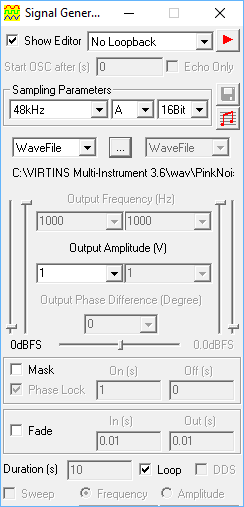

5. To play the filtered test signal, choose "Wave File" in the Waveform selection box in the Signal Generator panel and select the above saved WAV file for output.
