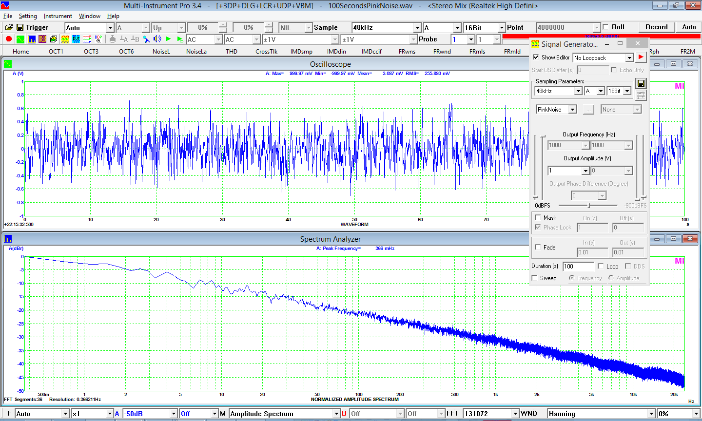

Re: Quit the server-client architecture and focus on peer-2-
Unlike most of the digital pink noise generators in the market, which eventually repeat the same segment of pink noise (for example 1-second pink noise), the pink noise generated in MI is "true" pink noise without any form of repetition. It is not band limited and thus contains very low frequencies that follow the "pink noise law" as well. The following figure shows the spectrum of a 100-second long pink noise save from the signal generator of MI. It can be seen that the signal contains very low frequencies (less than 1Hz) following the "pink noise law", i.e. -3dB/octave or -10dB/decade.

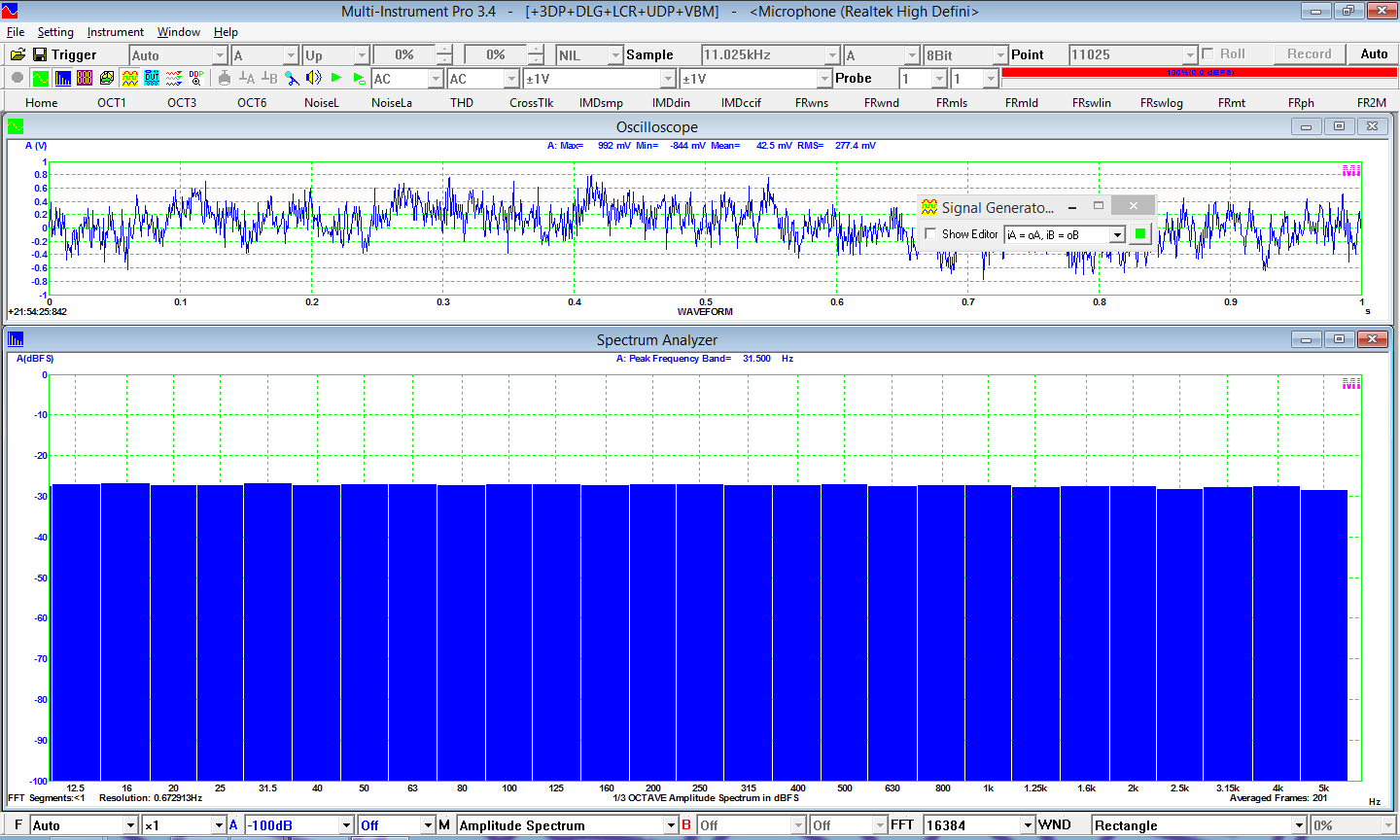

Anyway, the existence of low frequencies does not affect, in any aspect, the measurement accuracy in audio frequency range. In fact, it allows the measurement of frequency lower than 20Hz. The following are the pink noise spectrum under octave analysis. It is flat enough for any EQ measurement.
