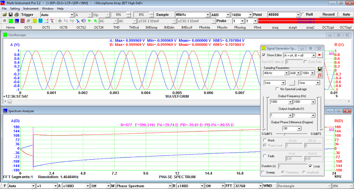

2/ a simple multi-meter display of the phase difference between input A and B, useful when aligning the heads on a tape machine.

2. There are two methods to measure the phase difference between the two channels.
(1) Use the phase spectrum together with the cursor reader to read the phase difference at a particular frequency.
Example:
