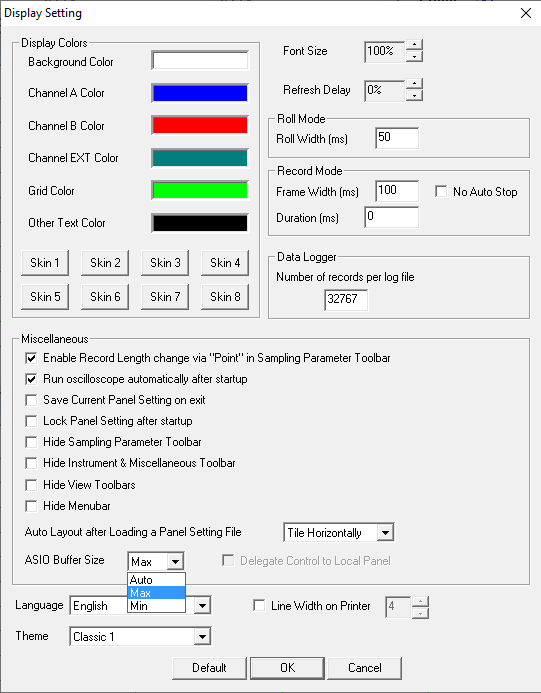

By default, Multi-Instrument will set the ASIO buffer size to Maximum. This helps the software to buy some time to perform some extra processing such as software triggering. Some hardware may not follow ASIO standard strictly, which causes "Buffer Size Exceeded" when the maximum buffer size is requested. You can change the default ASIO buffer size via [Setting]>[Display]>"ASIO Buffer Size".

This is the first thing I tried: Change this setting.
Unfortunately, it doesn't help.
I tried the 3 options. I also made sure the Topping driver was selected with same number of bits than MI
That still doesn't work.
2022-10-21 18_22_07-Display Setting_.png (734 Bytes) Viewed 208925 times

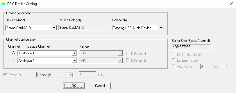

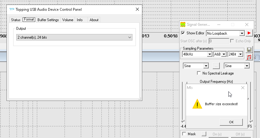

2022-10-21 18_22_14-DAC Device Setting.png (10.62 KiB) Viewed 208925 times
2022-10-21 18_22_47-Greenshot.png (18.69 KiB) Viewed 208925 times

That is strange if you have tried all the three options: Max, Auto and Min for both Oscilloscope and Signal Generator. The Max and Min options use the maxSize and preferredSize returned by the ASIO driver directly. Not sure whether it returns a correct size. Could you please show the Buffer Setting tab of Topping USB Audio Device Control Panel?

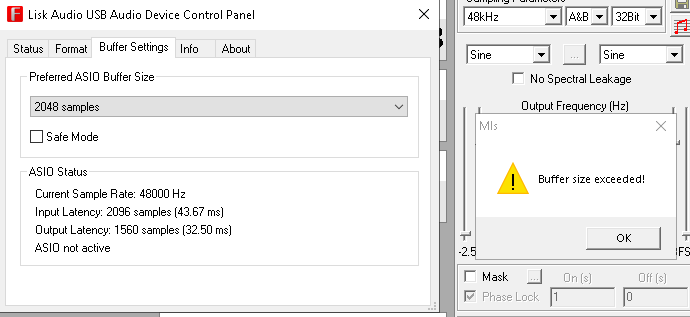

I just added a driver for Fiio BTA30 pro (DAC driver, with ASIO), and I have the exact same phenomenon
Buffer Size.PNG (12.58 KiB) Viewed 208752 times
This error shows only when I start the generator.
Of course, both devices are DAC only. Not ADC.

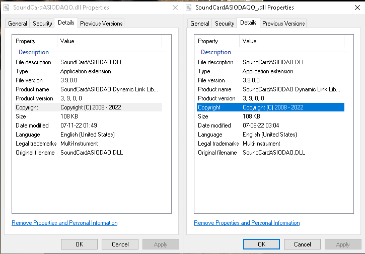

NB: Both DLLs have the same size

Still, I checked, and they are all different.
