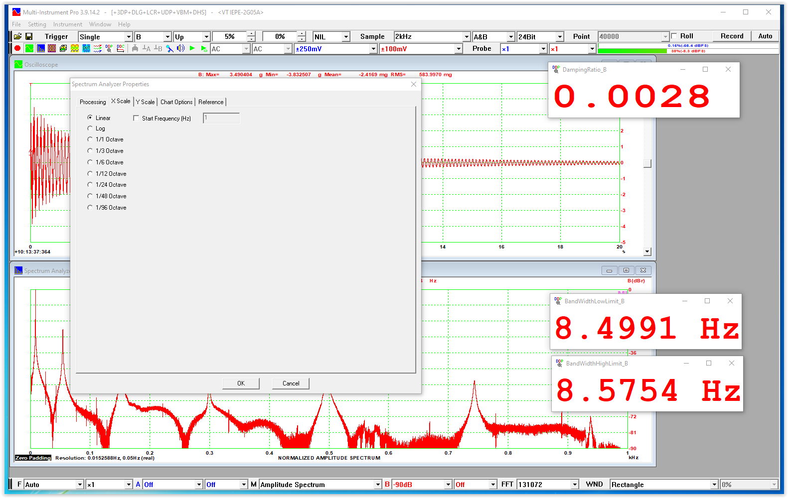

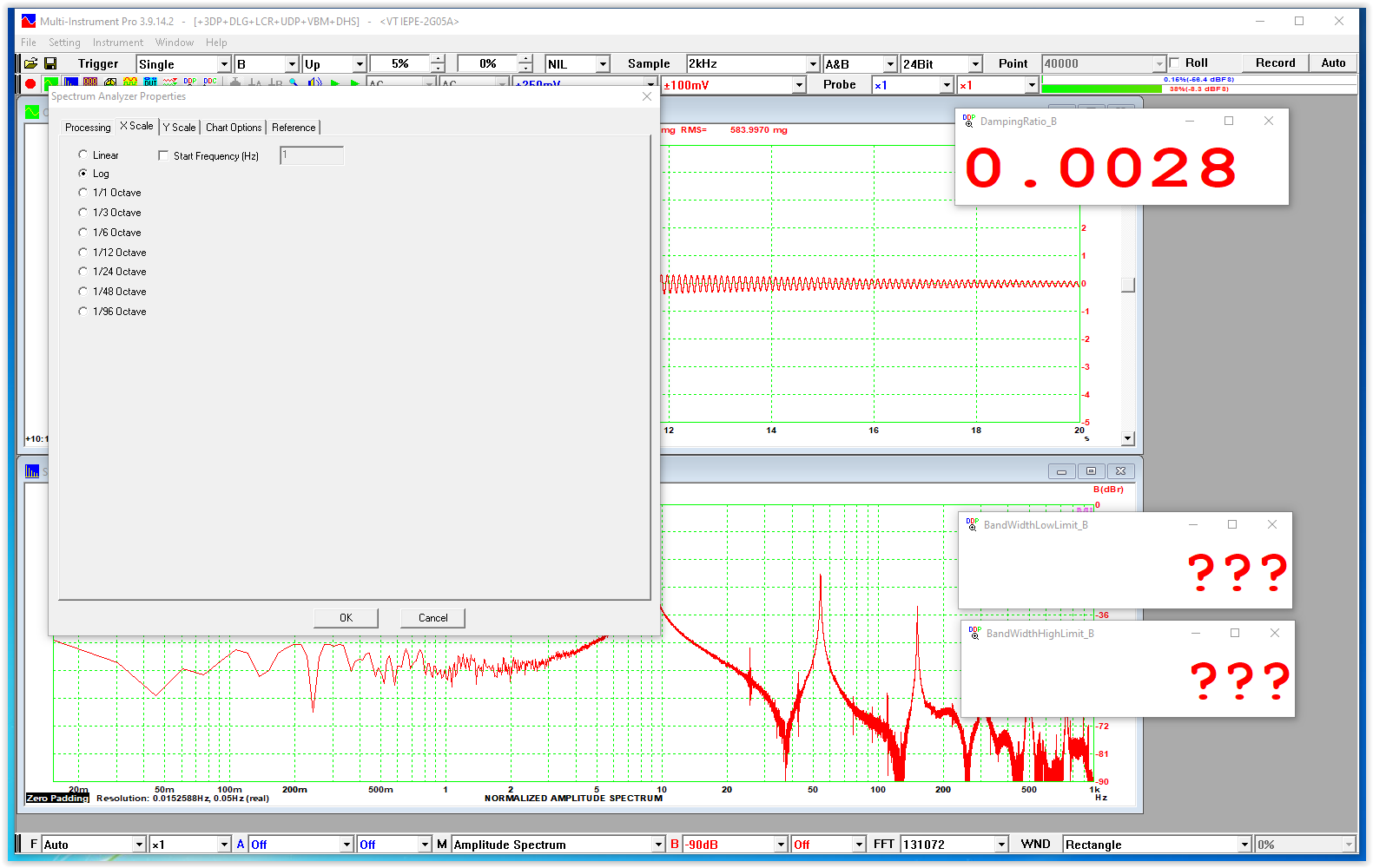

If the X Scale is set to Log initially, the DDP will not show the bandwidth information as shown in the picture below.
no bandwidth display
I have to use linear for X Scale to see the bandwidth data.
bandwidth available
