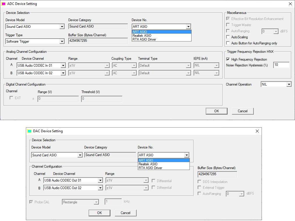

The software will interlock the selection of ADC and DAC sampling rates ONLY WHEN both ADC and DAC uses Sound Card ASIO drivers and the ASIO drivers used have the same sequential number in the Device No. selection box (see figure below). In your case, do the two have the same sequential number there? If yes, do they have a different textual description? Basically the software needs a way to know that the ASIO drivers used are for different hardware devices in order to disable the interlocking.

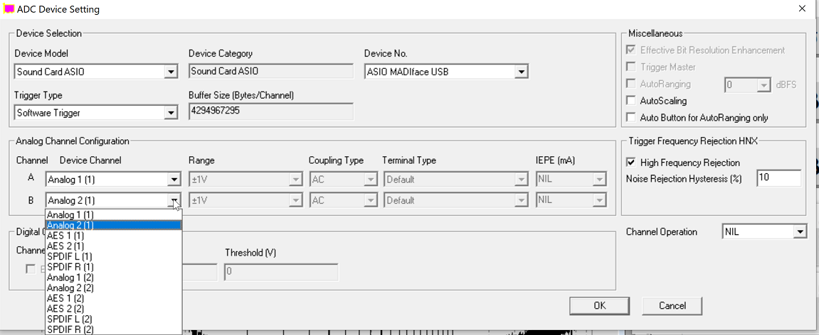

When selecting the ADC, as an example, it looks like this:
Both have same Device No, but device channel names are followed by (1) for first device and (2) for second.

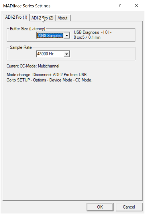

In "RME settings", both devices appear, and one may set the Sampling frequency independently... as long as the software doesn't force it :-(

It would be handy to have a checkbox to allow setting different Sampling frequencies in that case.
Of course, that won't work if that's the same physical device.
But in my case, that would make my life much easier...

Thanks for the information. Using two MI instances, with each instance pointing to a different sound card (for this particular case, it is done through Device Channel Selection), should allow you to change the sampling rate independently even if the two sound cards uses the same ASIO driver.
If only one MI instance is used, then your method - ADC using the original ASIO driver, DAC using ASIO4ALl, or the other way should also work.
