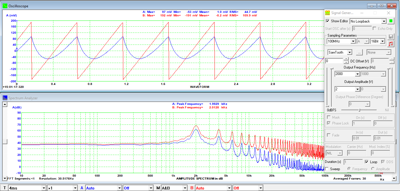

Can you please answer me a follow-up, which is probably a generic question anyway.
Can you help me to understand the relationship between the time sweep and the spectrum resolution? With respect to the attached image snapshot, I have a simple setup of a sawtooth stimulus (red scope display) feeding a filter (output on blue scope display). The spectrum is now showing all the harmonics of both input and output.
In order to get a reasonable time display, the time sweep is set to 4mS.
However, this seems to automatically set the Spectrum display to 500kHz (which is a bit wide for my needs) but more importantly it sets the FFT resolution to 30.51Hz which for the frequency of interest of the test is too wide and results in a low resolution spectrum display.
If I change parameters to get me a lower FFT resolution (say 1Hz) then it looks as if the time sweep has to change so that the cycle waveform is no longer visible.
I hope I have explained my issue. I guess that there are interactions between the parameters so that not everything will be possible, but an explanation would be helpful please.
Inter-relation of sweep and resolution.PNG (74.07 KiB) Viewed 42194 times
Bob

Re: Frequency response measurements
Postby wireless » Thu Aug 29, 2019 10:43 pm
SOLVED.
I have answered my own question - the solution was simply to use the small magnifying glass in the oscilloscope window - this allows the expansion of the time domain display whilst leaving the FFT resolution where it was already set.
Thank you
Bob

Postby VirtinsTech » Thu Aug 29, 2019 11:26 pm
Great! You have figured it out by yourself. Just to add, it looks like that the settings in your screenshot are as follows:
[Oscilloscope Sampling Rate] = 1 MHz, thus the frequency measuring range in the Spectrum Analyzer is from 0Hz to 500kHz (according to Nyquist Sampling Theorem).
[FFT Size]= 32768, thus [FFT frequency resolution] = [Oscilloscope Sampling Rate] / [FFT Size] = 1000000 / 32768 = 30.517578 Hz
[Oscilloscope sweep time] = 4 ms, [Number of Sampling Channels] = 2 and [Sampling Bit Resolution] = 16 Bits, thus the DSO memory buffer size consumed is 1000000 x 0.004 x 2 x 16 / 8 = 16000 bytes. Note that this is less than the max. DSO memory buffer size (Memory Depth) 40000 Bytes. In case this memory depth is exceeded, the software will automatically adjust the oscilloscope sampling rate or sweep time (depending on which one you are adjusting) such that the memory size required is within its upper limit. The software also set a lower limit (2000 samples at least per channel) as well, below which these parameters will also be automatically adjusted.
