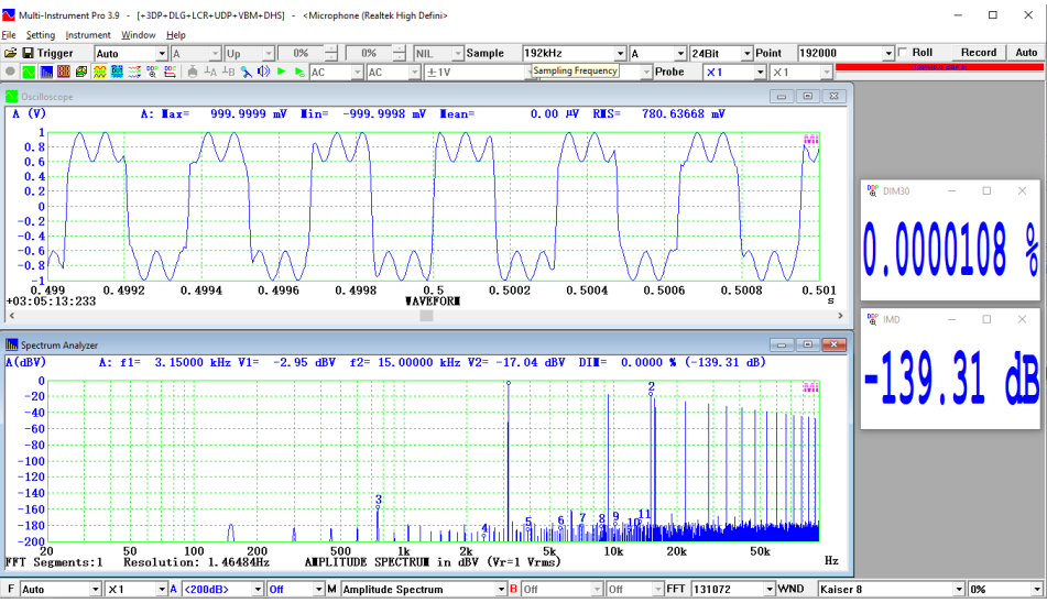

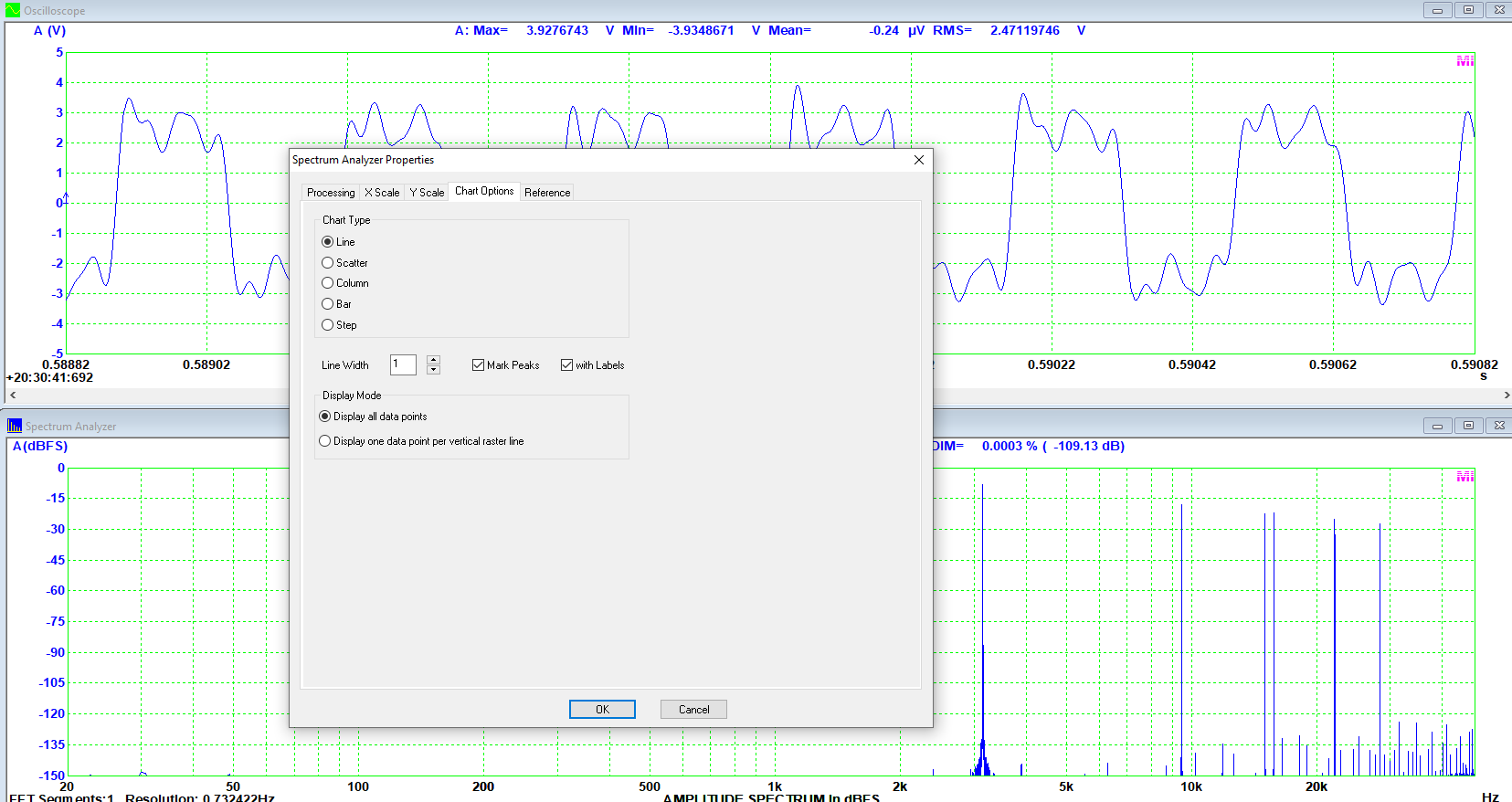

Hello! During distortion measurements, harmonic numbers are displayed in this manual https://www.virtins.com/doc/Measurements-of-Various-Intermodulation-Distortions-IMD-TD+N-DIM-using-Multi-Instrument.pdf. They don't show up in my program. What am I doing wrong? Attached is the settings file. Software version 3.9.7.3
The first screen is taken from the measurement guide. The second screen from my program.

Postby VirtinsTech » Wed Apr 05, 2023 12:29 am
Thanks. It has been fixed in the new version 3.9.8.0.
