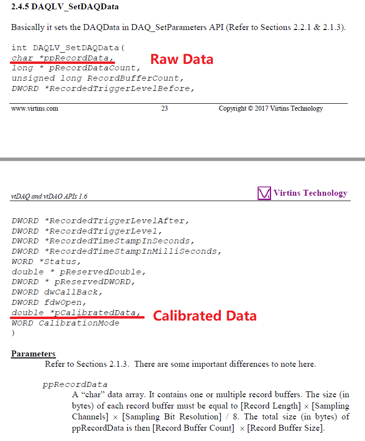

The pointer to raw data array and the pointer to calibrated data array can be passed to vtDAQLV.dll through DAQLV_SetDAQData API (see figure below, refer also to Section 2.4.5 of the vtDAQ and vtDAO API document).
If the calibrated data are not needed, let CalibrationMode=0 and pCalibratedData=NULL.

Thank you very much for such a detailed and quick response!
So, just to make sure I understand it right - the hardware calibration seem to be applied to the signal before it is digitized by the ADC, so as long as the parameters of the hardware calibration are set correctly in the hardware, all ranges are mapped to the "SamplingParameters.SamplingBitResolution" number of bits exactly; thus the only thing left to convert the raw data to volts is to use the conversion factor derived from the range value and the bit depth of the raw data (?).
Posts: 306
Re: Raw ADC data to volts conversion
Yes, you are right. The hardware calibration parameters are stored inside the hardware device (not the computer), and are applied to the signal conditioning circuit before it is digitized by the ADC, in order to fully utilize the dynamic range of the ADC chip.
